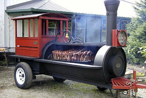

Gravatar #11 - Thalion
28. mar. 2011 15:52
